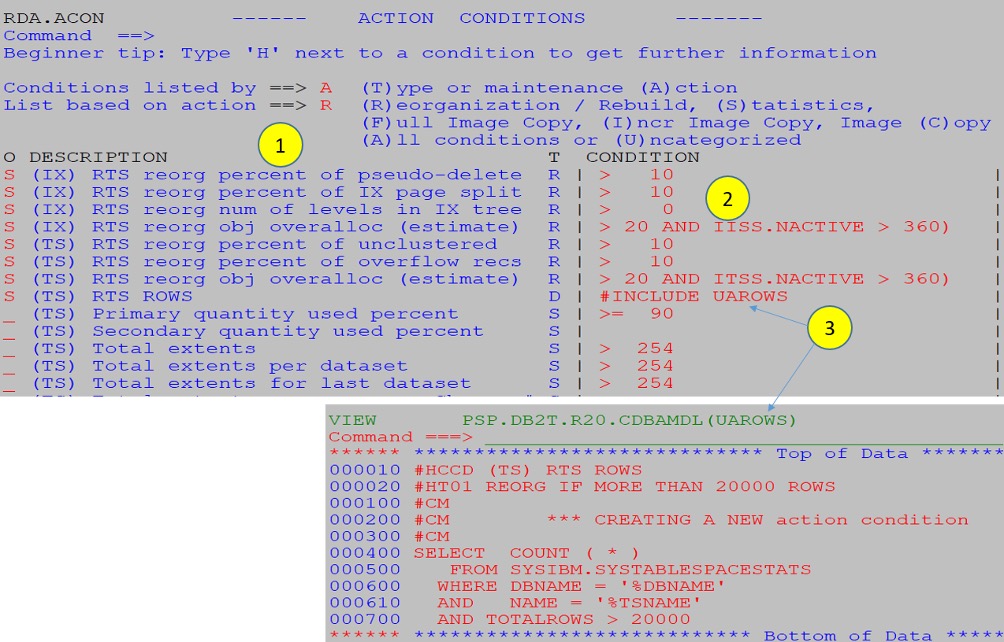

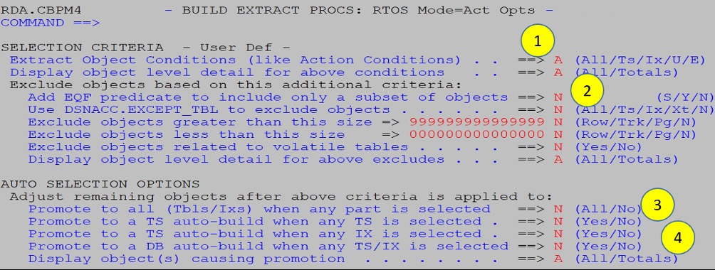

The following figure illustrates some frequently used features to define the scope of objects:
- Extract Object Conditions define the scope of objects based on RTS conditions
- EQF adds additional SQL filtering (for example, by excluding objects in a DBA exception table)
- Promote to the tablespace/index level when a partition is selected based on RTS conditions
- Promote the utility to be generated on the corresponding tablespace/partition when an index is selected
The following figure illustrates the ability to define the scope of objects with RTS thresholds or PDASTATS conditions:
The conditions list has been filtered to display only those related to reorganizations
Dozens of predefined RTS conditions are available (for example, for index page splits or an increase in the number of index levels that cause additional I/O processing)
You can also define your own custom conditions in SQL, based on your site-specific requirements
